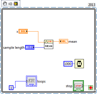

I am using the mean function inside another while loop. As a general rule I know due to dataflow it is a bad idea to run while loops inside while loops if you are trying to achieve parallel operation.
BUT...
I am using the mean function inside another while loop. When I open the VI up I can see that it is a while loop that runs forever. I can't figure out how labview has achieved this? Are there properties I can set to allow this if I want to replicate this type of execution?
Logically this should not work, but labview seem to have done it. Am I missing something?

No, it doesn't run forever - it runs only once. The while loop is used so you can use uninitialised shift registers to store the data between each run of the VI.
These two are identical:
(top one is continue if true, bottom one is stop if true)

Look into "Functional Global Variables" or "Action Engines" in LabVIEW. This same functionality of storing data in a shift register can be done by using a "feedback node" and by using a For Loop with number of iterations set to 1.
