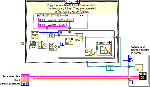

To test just wire from N to the outside via an autoindexing terminal and look at the resulting array.
The iteration terminal is not very useful. I sometimes configure the terminal to provide the parallel instance ID and use it to execute ID dependent code. (For example in this program I have N non-reentrant dlls, all with the same code, but different file name. The Instance ID decides which one to call. See picture from this discussion. For example I can just set "parallel instances=1" to see if parallelization even helps. Sometimes it does not!)
As a general rule, I would stay away from too much micromanaging of the behavior. Just leave things at automatic, it does a great job! It is sufficient to define the number of parallel instances.
