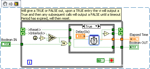

I have written a small vi that i believe can be added to your existing code to overcome the current problem you are facing.
What this vi does is when a true value is detected it outputs it the first time. It then sets a timer. Whilst this timer is active the sub vi will only return a value of FALSE no matter what the input is. Once the timer has timed out it will reset. Having looked at your code i believe this will sort your problem.
You can see above where i have added this sub vi in your code, in between the OR function and the Select case. The first time that you enter a true value, ie it alarms, you will select the 'Alarm State' state, all subsequent cycles will be forced to select the 'No Warning' State until the timer has elapsed. I have shown it here with a 20 second timer. You can adjust this to get the time you require.
Another quick point. I beleive that your 'No Warning' State is useless as all it does is select the 'DaQ Acquisition' state, which is the state you are currently in. Why not just select 'DaQ Acquisition' state from here?
Anyway, in summary, this will be just a quick fix as if you do not change the architecture im sure that you will encounter other problems, especially if some of the functionality changes in the future.
I will attach in LV2009 and LV 8.6 as you have not specified your version. Hope this helps,
Lucither
