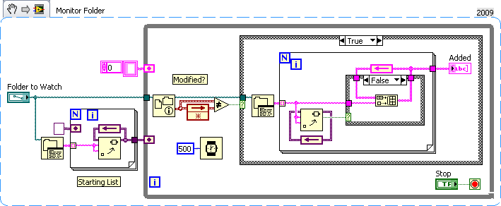

I usually use the .NET method myself, but if I were forced to poll I would do something like this.  I use a variant to hold the list of filenames.  I would only poll the folder info, when it has been modified then do the Folder List.  Any new files are spotted when the variant attribute does not exist (Replace = FALSE), and this is added to the array.

Could you please attach a VI for this example? Thanks!
Message 8 of 24
(5,100 Views)
That is a VI snippet.  The VI is embedded in the image.  All you need to do is drag and drop the image from your browser to a block diagram.
Message 9 of 24
(5,096 Views)
Does not work for me... LV 2009 SP1, MSIE.
