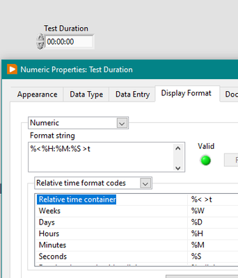

Hi GRCK,
@GRCK5000 wrote:
I just want to figure out how to implement for loop to simplify my code just in case I want more duplications later.
Why do you think a FOR loop would simplify this VI?
You may simplifiy your VI by replacing those HH, MM, SS controls by a single numeric DBL control and set it's format to <HH:MM:SS> (and maybe limiting its valid input range): no need for math to calculate number of seconds from 3 inputs…

@GerdW wrote:
Hi GRCK,
I agree that your timing inputs need work.
The format code is actually:
%<%H:%M:%S>t
(I will have to try and remember this... again. 😁 )
You can further simply by only having one case statement.
