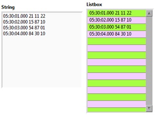

I have a VI which sends packets of data to a device and receives data. This is done using the serial port. I timestamp each packet and display it in a string control. I would like to be able to differentiate between sent and received packets by changing their colour / background / anything. I have investigated using a string control, a table, a list box and a richtextbox, but I am struggling to come up with a good solution. In the past in VB/C#.NET, I have created a log control using a richtextbox which can display formatted text, but I am keen to use a Labview control because I assume their is an overhead with the .NET richtextbox.

Something like this?
I used a listbox with selection mode 0 (0 or 1 items selected) and Disabled, so that the user cannot click and highlight on any item.
The string to be displayed is to be given to ItemNames property. The cell background can be set as per your need. I have just set alternate cells to different colours.

Thanks for the reply and the demo VI. I can apply the colour coding to a completed string, but I would like to do it as the messages arrive. So my string / display control retains the colour coding information and I just add another entry with the correct colouring which is then retained. I would like the control to be able to hold a few thousand lines and I don't want to parse the control and re-apply the colour code every time I add a new entry.

The messages themselves could be stored in a shift register array and wired to the Item Names property so updating the entire list shouldn't be problematic.  You could even have the array backwards (so new messages are added to the end) and then reverse the array just prior to wiring to the control.  This reduces memory usage for updating the array compared to inserting at the start of an array.
Unfortunately, the color settings are for an individual cell/row of a listbox can not be simply updated with an array of color values.  These would have to be updated for each individual row (since you plan to add new messages to the front, all cell colors are subject to change at each update).

You will have to build a cluster with {TheString,TheColor} store this in an extra array that gets updated. You delete old, add new and so on.
When ever needed you rewrite the array to the list.
Be sure to use "defer panel updates" while you are writing.
