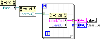

How can i get the reference to Controls from VI-reference
i have a VI with ~5 controls on it.
And with the Object "Current VIs path" and "Open VI reference" i can create a reference to the current VI.
How can i create now a reference to the controls? (Starting with VI-reference?
Of course i know how to create directly a reference from a control.
My idea wasm that there areperhaps properties like:
- Number of controls
- Name of control
- Type of control (string, bool. number...)
Is this somewhere there and i just dont find it?
Thanks for your help

Once you have the VI Refnum, it's a two-step process. Wire the VI Refnum into a property node and get a reference to the Front Panel. Output the Front Panel reference into another property node and select the property Controls[ ], which outputs an array of references for all the controls on the front panel.

Hello Jarrod,
this was exactly what i was looking for.
Thank your very much for your fast help.

I have a similar question which I posted new. The question is how to access the data in those controls through the references, except the label and ID?  thanks.
(5,349 Views)
Just use the value property. You'll get a variant because the property node won't know what type it is, so you then have to use 'variant to data' to convert this to correct type.
