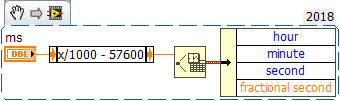

David Boyd just showed me how to do this using the Format option. It does it automagically.
Yours Sincerely
John
John Brohan         National Instruments LabVIEW expert in Montreal
Traders Micro         "We connect all sorts of things to computers"
Open LV Lib  index is at   http://bloghan.gotdns.org/OpenLVLibs/
