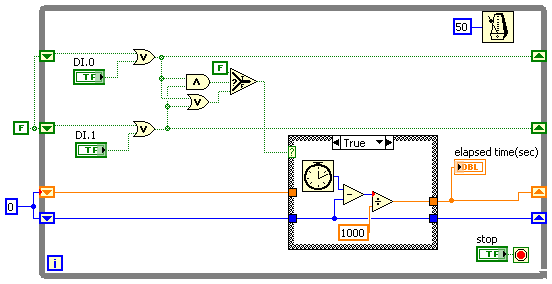

assuming your device does not have a counter....
Spoiler

Apok
Thanks a lot for your reply ,and yes my device does not have a counter input ,only the digital input .
I just want to know what the use for the two digital inputs *the boolean controls" ? can you please explain to me .

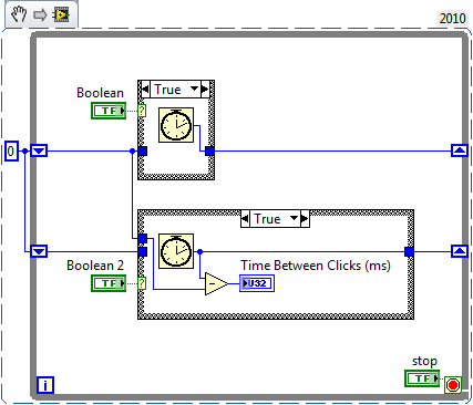

Accepted by topic author shadymohamed
Woah!  Smiley Surprised
Sorry Apok, but your code is becoming way too complicated/messy. I don't think that all of those shift registers or boolean conversion/operators are needed at all.
If you want to measure the timing between two button presses then this is a different (much less complicated) way. It simply records the timing of the button press into a shift register then compares the two.
Spoiler
Time Between Clicks - Simplified
Of course this is a very quick and basic solution just to show you that it can be much simpler than you are making it (remember to use the mechanical actions of the buttons to get the behaviour you want).
A better way would be to use an event structure looking at value changes of the buttons to determine the timings between clicks.

He has only one digital input.
