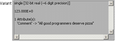

As I understand it, that's a pretty interesting idea - kinda like a comment-field that's an attribute of each data-element - but for that, you could use "Set Variant Attribute" to create a "MetaData" (string) attribute that would follow each variant - no?  I haven't used these at all besides a brief experiment just now that appended an attribute called "Comment" to a variant.  If this is on track, see attached!

Really thought this was what was requested - access to the Variant's "Text Box"!
