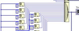

See the figure. I use many times the yellow icon, but Can I use only one icon in the for cycle? But I must put, like the figure show, the out of every cycle in one of input of merge icon. It's possible?00000.jpg

Vanny,
instead of splitting up your numeric array and convert it into the dynamic datatype using the "merge signals" function, you can use the "To DDT" (to Dynamic DataType)and configure it to "1D array of scalars - multiple channels".
hope this helps,
Norbert
EDIT: Other possible ways to remove the multiple instances of "Index Array" are:
- Use a single Index Array and extend the input "index" by pulling down the bottom border of this function. You then can connect multiple indices. Note that not connecting any indices will work too since LV will use index 0 as first and then increment each index.
- Use an "Array Subset" to read a range of the original array
Message Edited by Norbert B on 02-09-2010 02:24 AM
