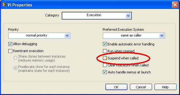

Hi, I have done the VI, but, when I run it, before setting my Signal Generator, appear a Strange Window: Utility Default Instrument Setup and appeare a Red Break Point (see the Figure) that stop the execution of my VI.
I understand that I must do CLEAR BREAKPOINT, but I don't want to do this every times. I want delete this stop.

With the VI in EDIT mode.  Right-click the wire with the breakpoint and select Breakpoint>Clear Breakpoint then resave the vi.  If you save a vi with a breakpoint in it the breakpoint gets saved too!  This can be especially troubling for users if the developer fogets to remove breakpoints when they release a build.

Jeff Bohrer absolutely NO. I have done what u wrote, but the problem is other!!! I have cleared breakpoint and i have SAVED. Now Break Point isn't present, but the execution is stopped and compare this window:
I must click on the strange arrow to the left top. And the VI continue. Why?

You've got the breakpoint cleared and now your only problem is that you have the VI in 'Pause' mode. Click the red pause button (||) and change it to black. Now, when you click on the run button, the VI will execute all of the way through.

Your vi is paused.  what version ap LabVIEW are you using?
With LV 6.1 and previous a sub-vi could be set to suspend when a control value was out of range.
With all versions a vi execution properties may be set to "suspend when opened"
Or you may have more breakpoints.youcan search for all breakpoints from the heirarchy window
(and if I recall correctly- LabVIEW 7.0 had a bug "phantom breakpoints" that would not clear a BP that had previously been saved in a library until the library was resaved and LabVIEW restarted)
