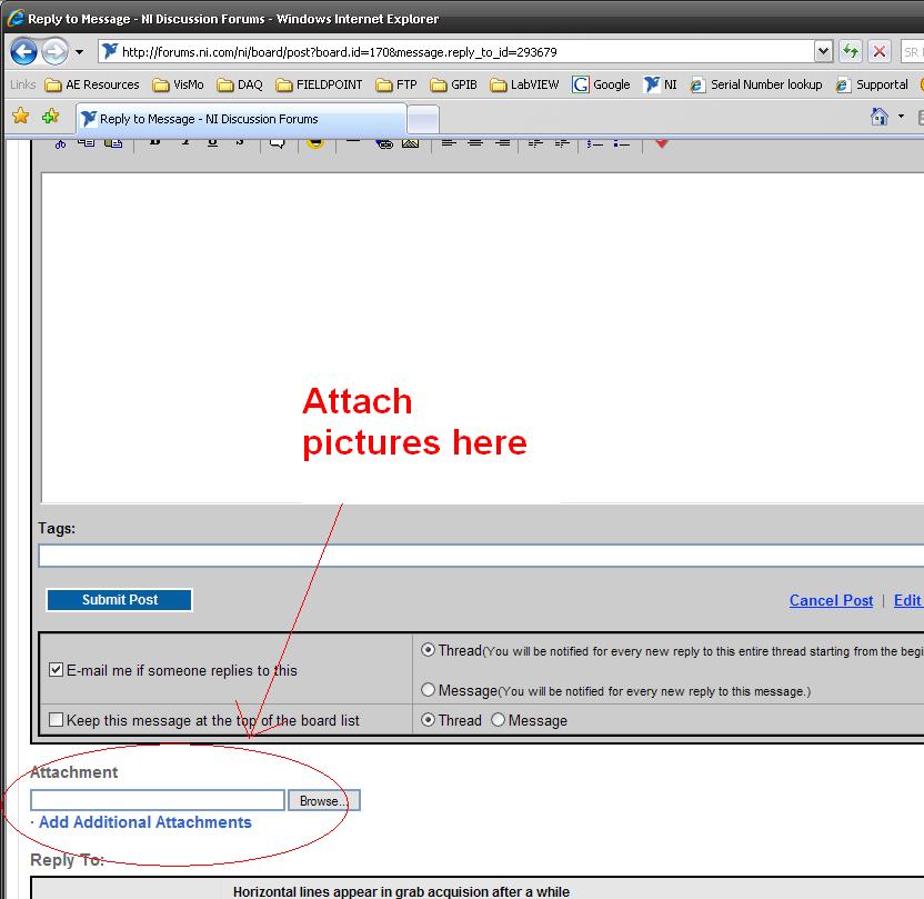

Damn! How do I add a picture to my post?

This button opens a dialog to insert an image.  You need to find hosting on your own, though.

Now I understand.  I was using Opera and I don't see it like this.  Anyway here it is.  On the first image, you can see the fiber optic clearly when using snap.  The two others image is when I use grab.
