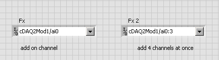

One mopre thing though, I've had a quick look at your VI, just a trick, you could save a lot of diagram space by adding channel by bulk instead of one by one :
