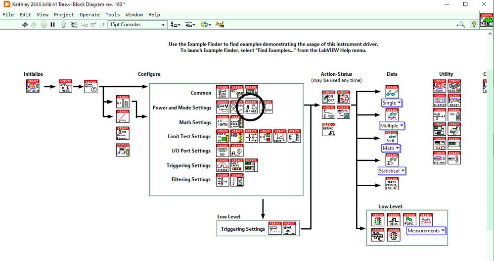

I am working with a LabView with a program for discharging the battery, but the manual Keithley says that is necessary to set the High Impedance, I know how to do it in the equipment, but not in the program, do you have any suggestions?

If you are using the K24xx LabVIEW driver available from:
Then open the VI Tree.vi and locate the Ouptut Off Behaviour VI, select High Impedance.
If you are sending SCPI commands directly, then the command is ":OUTP:SMOD HIMP;"
See the Manual Section 13-11 - Remote output configuration.

Thanks so much, Craig.
Sure, I see that.
