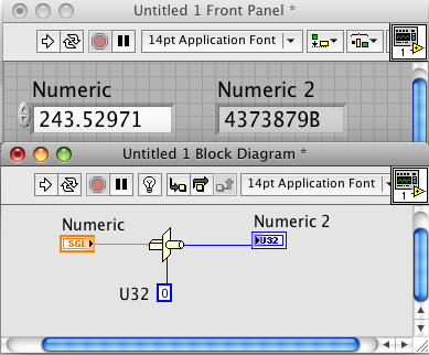

Hi Steve ,
As promised I have been able to get a few more samples and the result values in decimal . Reproduced below is the HEX response byte from the EM6400 and the corresponding decimal result as shown in the SimplyModbus test software :
Response                                   Result
01 03 04 87 9B 43 73 D3 BD     243.52971
               6E C8           17 F0      243.43274     ( Giving only values that are different from first row )
               74 B1           C1 31     243.45583
               5B B9           48 27     243.35829
               42 0B           EF 5C     243.25798
               4E 5D           DC 1C     243.30611
               44 EB           EE 22      243.26921
( 01 = Device ID; 03 = query type ;  and the last two bytes are the CRC value. Not sure about others)
 Does the above ring any bell ??
Raghunathan
LabVIEW to Automate Hydraulic Test rigs.
Message 15 of 24
(3,905 Views)
It's easy enough for YOU to find that out - now that you know the "correct" answers, you can find where the data is:
Since you know that line 1 (for instance) is 243.52971, that there are 9 bytes in the line, and that 4 of them are accounted for, then you know that it cannot be a DBL, it has to be a SGL (there are no 5-byte floating-point formats).
So type cast a SGL with one of the known values into a U32, and display it in hex.
Find that pattern in your data stream and make a rule for decoding it.

Raghunathan,
Byte 1 = Device ID/Address
Byte 2 = Query Type
Byte 3 = # bytes of data
Bytes 4-7 = Data
Bytes 8-9 = CRC
I took your SGL results and type cast them to a U32 and looked at the hex representation.  Picture below.  Notice that in each case you returned 2 of the 4 bytes correctly.  Notice that bytes 4-5 of your returned data matched the two lower bytes of the expected hex data.  As I stated previously I'm pretty sure you are using the wrong register address in your modbus query.

Hi Wayne,
While Steve had pointed the way to find the solution( 1 Kudos) , I was under tremendrous time pressure with other problems. Thanks for the posting with array. I can now work it forward. (Solution!)

Wayne.C wrote:
Raghunathan,
Byte 2 = Query Type
Bytes 4-7 = Data
Bytes 8-9 = CRC
Actually if you look more closely, all 4 bytes are correct, it just formatted that bytes 4-5 are the least significant word and bytes 6,7 are the more significant word.  If you do a swap words before typecasting it to a single, it is just fine.
