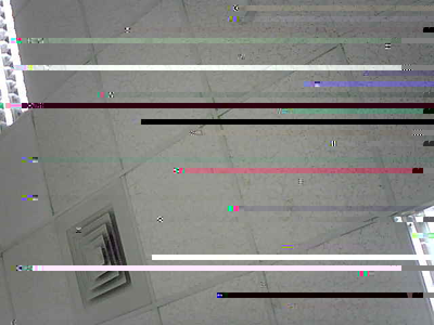

Hi praveen,
your "saved file" only has some errors in the file, I could open it with IrfanVIEW and save it as PNG:
(Looks like a typical office equipment. :D)
Those "colored bars" are typical for data errors in JPG images: JPG stores data with a minimum block size of 8 pixels. With an encoding error the JPG decompression shows those artefacts…
So you need to make sure there are no errors in transmission of your JPG data!

Thank you for your efforts and guidance. By the way, what is the issue in the .jpg file?
Is that saved in correct format??
It will be helpful if you say the error. IrfanView opens the file. In my case, My objective is to save the images automatically to the hard disk via LabVIEW software.

Hi praveen,
I can't "say the error" - I can only guess there are some transmission errors between your device and your computer leading to invalid data in the JPEG stream.
Some software is more strict about such invalid data (like GIMP being unable to open your JPG file), other is more tolerant like IrfanVIEW.
So I repeat: check for any transmission errors between your device and your computer!

Dear GredW,
FIne. I checked the data from the camera and the count is correct need to verify with the checksum. Thank you once again.

Dear GredW,
Thank you very much for your great guidance. I got my result.
The thing is I need to order the data from FFD8 to FFD9 that the image info. Actually, the camera sent the header as well as the checksum. Those are not needed.
I am just posting this coz someone can use this info in future.
