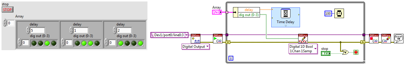

I am using an Ni 6009 with labview 2012 to turn on/off 4 valves. I am to the point where I can manually turn the valves on/off in the front panel, but what I need to do is have a timed cycle.
What I need to have is for example:
1) Valve 1 open, Valve 2 open, Valve 3 closed Valve 4 open.
2) Wait x amount of seconds.
3) Valve 1 open, Valve 2 closed, Valve 3 closed Valve 4 open.
etc.
How can I make this happen?
I'm fairly new to this program, so any help would be greatly appreciated.
This is what my block diagram looks like, it is attatched.

I would suggest you use an array of clusters. The cluster would have a Boolean array and a numeric for the delay value. You only need a single DAQmx Write that you pass a 1D array to - representing all channels for a single state. Do not configure, start, close with each iteration of a for loop. Wire the Time value to a Delay function. An array is passed into s for loop and the auto-index feature will give you one row each iteration.

Am I to have 4 booleans within each cluster? Then have x amount of clusters in the array?

I think I almost have this complete but I am getting an error message that I am unfamiliar with, can someone direct me on how I can fix this error, I have a picture of what I have and the message I am receiving. I'm having trouble connecting the physical channels.
Message 5 of 13
(3,897 Views)
Try creating the task in MAX, where you can specify the 4 lines (Dev1/port0/line0:3).  Then in your DAQmx Create Virtual Channel.vi (in LabVIEW), wire the task you created into the "task in" input as a constant. (It will auto-populate in the pull-down menu.)

How did you unbundle the array??? Im getting that it is of two different types, one is an array and the other is a cluster.

The only difference is that you used the unbundle function and the example uses unbundle by name. Does not make a bit of difference.

I got this working, but is there a way for the array to reiterate? I want this sequence (picture is attatched) to occur over and over until the process needs to stop. I may need to have to run this for hours.
