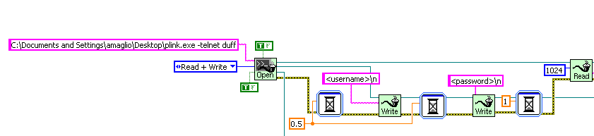

I would like to be able to use OGpipes to interactively communicate with a UNIX machine by launching a telnet connection using Putty.exe via the OGPIPE Open System Command__ogtk.vi. I have seen alot of posts about the OGpipes stuff and it seems like this is the kind of stuff OGpipes was designed for but I just can't seem to get it to work.
I can launch the telnet session no problem using the System Exec.vi. When I do this, a Putty window opens prompting me to enter a login name and a password. I can then login in and begin communicating with the UNIX machine through the Putty window, I want to be able to do this programatically using the OGpipes VIs.
To my understanding the OGpipes stuff is capable of this. I believe that the output that is normally displayed in the Putty window can be routed to the output of the OGPIPE Read From Pipe__ogtk.vi and then commands can be sent to Putty using OGPIPE Write To Pipe__ogtk.vi.
I cannot even get the OGPIPE Open System Command__ogtk.vi to open a Putty session. When I use this VI in the same exact way as I use the System Exec.vi the OGPIPE Read From Pipe__ogtk.vi times out.

I figured out the solution to my issue. The whole problem is that Putty is not really a command line interface application, but Plink is!!! I am now using Plink and everything is working perfectly I can interactively communicate with a terminal on a remote machine right from LabVIEW, these OGpipe VIs rock!!
