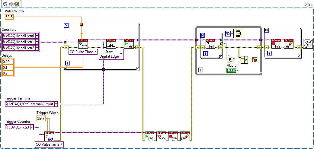

Exactly.  From here it looks like the original poster has a 9174 chassis--I would do something like this using the counters (you'll need to add a digital I/O module such as a 9401):
It will give you 12.5 ns delay resolution with 50 ppm accuracy--you will never achieve close to these numbers with software timing no matter how optimized your code is (consider the non-determinism of the bus transfers alone...).

Why use three seperate physical counters instead of one?
You will be driving 3 different digital outputs, no?  One counter can't simultaneously generate 3 unique pulses on different output lines.
When do the three counters end counting? I'm assumming this affects the 'DAQmx is task done.vi' function.
"DAQmx is Task Done?" will return TRUE when the counter has finished generating its pulse (essentially the sum of the delay and pulse width specified).
I don't understand why you need a trigger counter? What is it doing and how long does it run for?
It generates a single pulse that starts the other 3 counters at the same time t=0.  This allows all 3 of your counters which are actually outputting pulses to start relative to the same initial time.  If you're pressed for counters you can get by with 3 by referencing the initial delays to the output of the first counter and using that counter's internal output as the start trigger, but since you mentioned that the order might change I figured it was easier to just do it this way.  You could alternatively provide an external TTL signal as a start trigger.
It runs for a very brief period of time (100 ns pulse duration).  The act of starting/waiting/stopping/clearing will take several ms in software though, but it's irrelevant to the timing of any of the output pulses.
What would be the best way to measure the delays to see if they are consistent with the specified values?
If you're concerned you could scope it.
What is the point of the 50ms delays in the while loop?
The loop is just polling for each of the 3 tasks to check if they are finished--this prevents the loop from consuming unnecessary CPU (50 ms seems like a reasonable polling interval to me, you can change it if you really want to--it has no impact on the signals that are generated).  If you don't like polling you can use DAQmx Events to tell you when your output has completed--I didn't include them to spare myself the trouble of having to explain it.
Best Regards,
John Passiak

I'm getting this error:
Error -50103 occurred at DAQmx Start Task.vi:1
Possible reason(s):
NI Platform Services:  The specified resource is reserved. The operation could not be completed as specified.
Task Name: _unnamedTask<AF>
Are you specifying 4 different counters?
Best Regards,
John Passiak

Oh, the 9401 is a little peculiar.  Try reserving your tasks first:
You don't need to call DAQmx Write--the pulses should be present on the default output terminals (check MAX device pinouts for the defaults) or you can use a DAQmx channel property to explicitly set the output terminal to some other PFI line.
