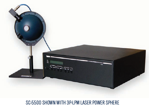

Has anyone written a driver for the Labsphere SC-5500?
I am hoping to obtain a driver for this particular instrument. I was curious to know if anyone in the past has written one.

I did indeed call the manufacturer but they do not possess any such software. The device does come with documentation with programming commands, and sample programmingh for C++ and QuickBasic using the RS232 and IEEE ports. I did begin to try and develop my own driver using the I/O Assistant. However, when I would enter any of the provided programming commands in the command line of the Assitant, my instrument gave back the message "Invalid Command." This does mean that the computer and the instrument are communication, however it is not accepting any of the manufacturer provided commands.

So after playing with the instrument in MAX, I noticed that despite the INVALID COMMAND ERROR message that was displaying on the LCD of the instrument, the instrument was still performing the commands that I was sending it. So I went back to the I/O assitant and started to write commands in the read/write/parse despite the Error message. Things were quasi successful here, however there were fluky and inconsistent behaviors with the instrument and the computer. I'll keep things updated as to the progress of the project.
