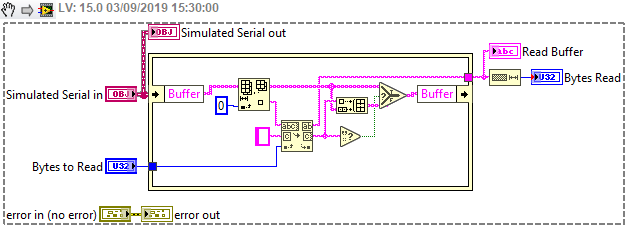

Sim-ReadSim-Read
These are the defaults - writing and reading from a string array. If you don't manually (i.e. in a test case) write the buffer, then you'll read back whatever you wrote.
The code in the Read will re-prepend the message if you read too few bytes. Termination characters aren't really handled - it's just assumed that the message you write always ends appropriately and ends up in the buffer. YMMV.

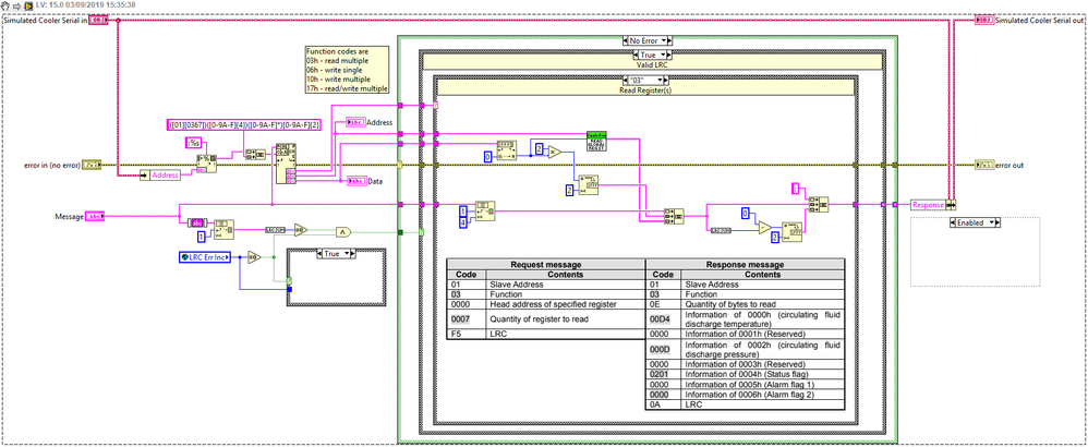

A more detailed Write.vi. This one checks a global variable (...) to determine if it should parse the message or not. It still calls the parent method to store in the buffer, but the parsing can be written in the test object (Sim Cooler) if you want. You can make this as detailed as you like, but of course, if your code here doesn't match the real hardware, you'll be testing against an invalid target...
Sim's Parse MessageSim's Parse Message
The Parse Message VI is responsible for the backend of the testing object. Here I've pasted sections of the device manual to help me check values, and used a global variable to hold the state of the device between Reads and Writes.
The VI also allows for checking the LRC (checksum) and if it fails, ignoring the message. It has a global variable that allows simulation of a failed checksum (e.g. due to noise, perhaps) so that the real Cooler code can see what it would do in that case.
