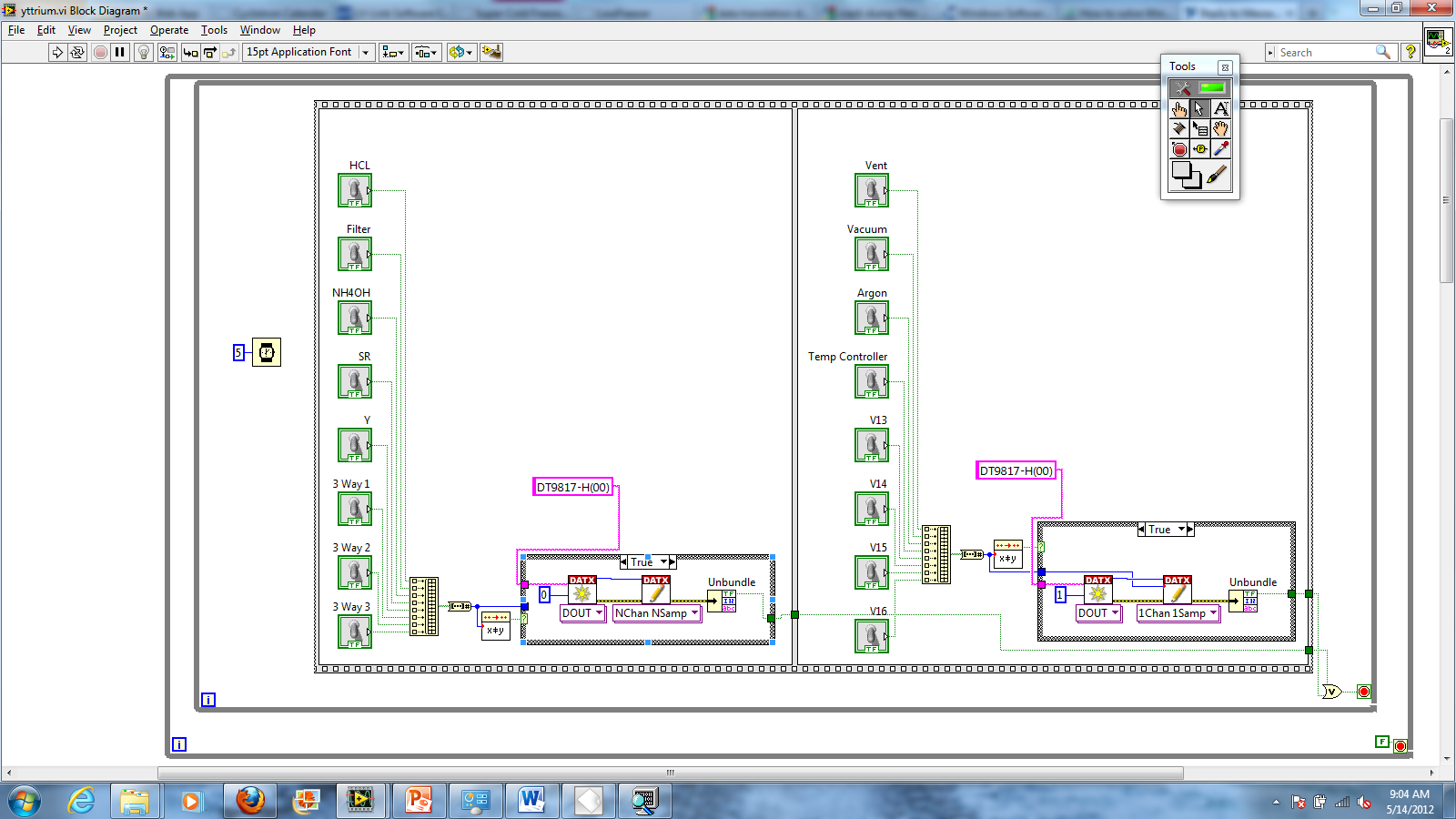

I began working on a new project that involes a dt9817 using 18 or so D/Os and then they had purchased a 9812(10v) for the 4 A/Is needed. I didn't seem to have any problems setting up the D/Os, in a while loop I referenced the 9812 and put in a write function. Now when I created the A/Is I did it just like I had before for a single A/I. I spent a little time figuring out how to get them to read from the correct port, but eventually figured it out.

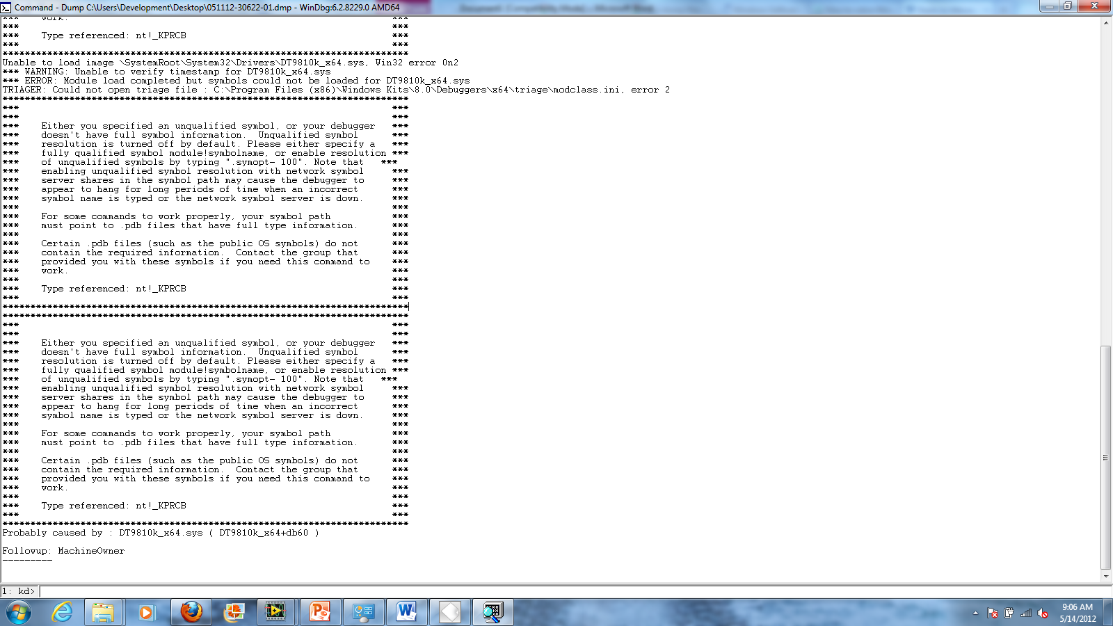

The problem is now that sporadically when the program is running, the computer will go to blue screen and then restart!! The only significant things I have time to see before it restarts are:
DT9810_x64.sys
bluescreen error
code: 50
I know it has something to do with DT Link as it is almost the only thing in the program and it only goes to bluescreen when the program is running.

I have gotten to an executable on a few projects and I have seen the error come up on both the development computer and target computers. It has been narrowed down to a problem with the digital outputs, and the LV Link digital output driver. Unfortunately the Data Translation people have been less than helpful, so I was hoping that someone might be able to post some example code to work from.
This is the crash dump file from the last time I got a blue screen. If it makes a difference, it was taken from a computer with an executable.
Here is the code that pulls the error.

sorry, the last part of the dump file is:

I'm not familiar with the device you are using.  But looking at your code, it appears you are creating a resource with the DatX subVI's that have the sun on it.  Then you are writing to the device.  I don't see any subVI where you are closing the resource.  So if you are doing this over and over again in a loop conitnually creating resources, you may be running out of memory.
In a normal LabVIEW application that uses DAQmx, you would create a task, use the task, and then close the task.  If you are doing this repeatedly, then the creation should occur before the loop, and the close should happen after the loop.  Only the repeated process of using the task would occur in the loop.
If that VI you have with a sun on it is a "creation" type of subVI, then I would not put it in a loop.

That hadn't occured to me, but I will try adding in a close block and see what happens. I will post when I see something! As the error is very intermittant I don't know when this will be.

Unfortunately after some testing I had the blue screen error show up twice. This was with the close task now in line with the do's If there is anything else anyone can suggest, I would be greatful.

Were the create task and close task inside or outside the loop?  Don't open and close repeatedly in the loop.  Open once before the loop and close once after the loop.

Yes they are. As far as I can tell they have to be opened inside the loop because I am trying to write to 3 different channels, so whenever I want to switch to writing to a different channel a new task has to be created, correct?
