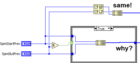

@Asasafuchi wrote:
Here is the vi that does the interval check:
Can you explain what the five inputs represent (cannot tell from the labels!) and how the boolean output should depend on them?
This is just pure Rube Goldberg code with convoluted constructs, way too much duplicate and unnecessary code.
Here's just the tip of the iceberg:

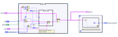

I think I got what you need.
You probably have a main vi that receives the array with the brackets. then run your subvi that gives T or F.
The Program needs to detect if the letter needs to be added as a new column (same group in your terminology) or be added as a new line.
The tricky part is how to update the 2D array properly.
You need to carry one additional information that is the number of elements on each line.
So the main VI will have a For loop with 2 shift registers, one for the 2D array string and anther 1D array that carries the number of elements.
So for each new line you evaluate, you detect the Letter to evaluate the range (witch group it belongs to) then T /F and the sub that evaluates where this new letter should be added to , if it's a new column or a new line. Finally, it also detects how many elements the resulting 2D array will have  (with the number of elements that are not empty) that is going to be used on the next iteration
Message 10 of 36
