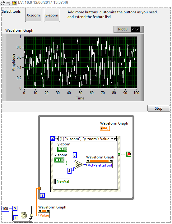

What I want is to have access to these various tools and display them in the same line or even to change these icons?

You cannot change these built in features. But you can hide them, and program custom controls which will look and function as you want. But this can be quite a large work, depending on the feature list you want to implement. I would not recommend this for a beginner.
So you have two choices: live with the built-in control set of these Graphs/Charts, or you program custom ones...
edit: some hints how to proceed in the way as cbutcher recommended it:
You can select programmatically the Graph palette tools, and also hide the built-in one. After this you only need to create some custom buttons with such graphic as you wish. From the property node "ActPaletteTool":
"Sets the tool that is currently selected on the graph palette. 0 is the selection cursor and 1 is the panning tool. 2-7 are the zoom tools: 2 is Zoom to Rectangle, 3 is X-zoom, 4 is Y-zoom, 5 is Zoom to Fit, 6 is Zoom Out about Point, and 7 is Zoom In about Point."
