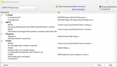

I'm not sure what you are hoping to do with this info, but there is a mechanism that NI has to find comments in your code. They are call bookmarks. If you put a comment on you code and you place a # sign in front it will leave a bookmark. You can then call the bookmark manger and go to those comment later.
Here is how to get to the bookmark manager:
It will open this window so you can navigate back to these later:
not sure if this helps or not but there is a built in mechanism.
