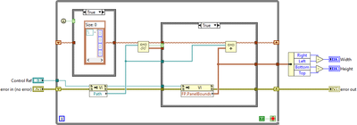

Thanks for the minimum panel size suggestion -- I had considered this already, but the issue with this is that it would then make the initial (and ideal) size the same as the minimum, so that if the control happened to be shrunk at runtime it wouldn't scale properly down.
Anyway, I'm now just caching the VI.FP.PanelBounds after the first open of any control VI, and this seems to be working well so far.

Accepted by topic author carls__
For completeness, calling a VI that does this before attaching each control seems to be doing the trick (so far):
