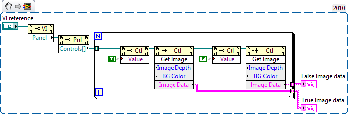

Well you can use the Get Image method to get an image of the current state of a control.  You can then programatically change the value of the control to get other images.  However I'm not sure of any way to do anything with hover over states or anything.
Something like this might do, but obviously you'd have to add more options for different types of controls/indicators.

Thanks... I already have an implementation wherein I extract the control image in a similar fashion to how you are describing. I was hoping that there might be a solution that doesn't require manual value changing as I would like to avoid dealing with specific control types. Additionally, I am getting the control images from a remote system and would like to avoid changing the values in a already running application... Is there a way to clone a control in LabVIEW 8.2 such that I could change the value without impacting the running application (I know this can be dones with scripting in 2010)?
Sorry if this seems like a confusing undertaking but the purpose of this experiment is so that I can extract control images from an already built / deployed application, loop over all the controls in the VIs stored in memory, and get the controls and their various image states. This way I have a nice image library of each control in the application along with what they look like under various circumstances.
(3,992 Views)
Unfortunately, I do not think it is possible without scripting.  Do you have the source code available that you can just open up on your local computer?  This seems to be a much easier approach then going through  all the trouble of what you're trying to do.
