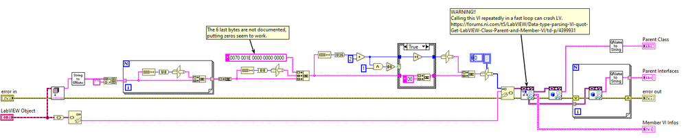

I've found 2 different ways of achieving this:
Solution 1: Build a variant from scratch (using type string and data string) and use it with "Get LabVIEW Class Parent and Member VI Information". This is very fast but I found the mentioned VI can crash LabVIEW when used repeatedly in a fast loop. Here is the forum thread I created for this: https://forums.ni.com/t5/LabVIEW/Data-type-parsing-VI-quot-Get-LabVIEW-Class-Parent-and-Member-VI/td...
Also, the whole type descriptor of the LabVIEW class is not documented.
Solution 2: Use a private Linker method. It is a bit slower, but it seems more stable. The method not being documented either, it should be tested with more complicated cases to ensure it never misses any interface:
Raphaël.

Great info thanks! I have had issues with that linker node giving inexplicable errors - it's used by Caraya which runs it on all your VIs in certain setups. But I'm already using Caraya so I think everything is ~guaranteed to not error.
(1,380 Views)
That node and its sibling to write that information to the VIs on disk had in the past repeatedly changes in the datatype of the cluster that is used.
And them being a private node, they did not receive the same attention as official nodes to not crash if wired with incompatible data, respectively to have mutation code update the diagram when a VI is upgraded from an earlier version.Most likely there is also no back-mutation for VIs that are backsaved to earlier version.
These nodes definitely belong in the famous LabVIEW attic. The LabVIEW developers put a lock on that door but any lock can be picked. Behind that door are wondrous things but sometimes also dangerous ones. And there are frequently rusty nails, so thread carefully!
