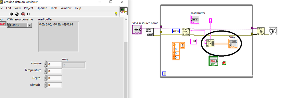

Okay so I'm trying Spreadsheet String to Array
This is the program I've designed, but I'm not getting any value in the array.
What am I doing wrong?

Try using a single dimension array here
If you are using the Arduino Serial.PrintLn command to send your data. Enable the Termination Character in the VISA Serial Setup and make sure it matches what the Arduino is sending

Hi sarwat,
Why do you think you need a 4-dimensional array to store 4 elements in a 1D-array (aka vector)?
Did you do the basic LabVIEW courses? Have you learned about basic array handling in LabVIEW?
