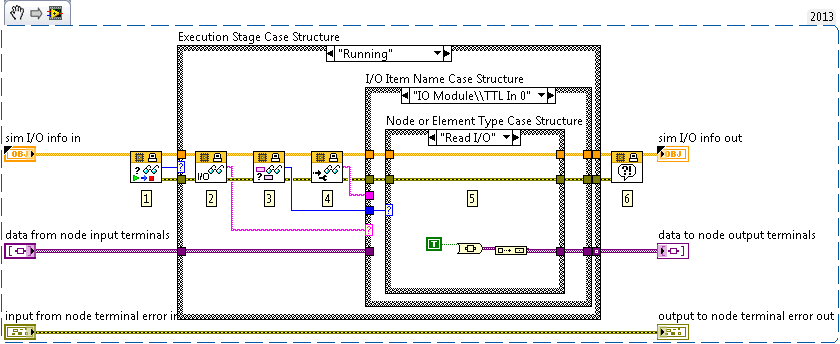

which could make sense as the IO simulation VI (simTb.vi in my project) is not tested (can't do that without the fpga target under test). This is shown in part below. Note that it is the auto generated template from fpga simulation setup dialog.

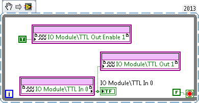

and here is the fancy fpga target vi under test (yes i try to make life easy:-))
So no host vi for communication with fpga - just the simualtion test bench.

The error message (-61399 above) is telling that the "IO Module\TTL Out Enable1" is not handled in the Simulated IO test bench
It is important that all IO's are dealt with in the "Simulated IO test bench". This make sense at least for FPGA inputs which need to be driven to some state.
For FPGA outputs it is not obvious why a handler for the port is required in the test bench. Any comments on that?
(4,267 Views)
You are correct in thinking that simulated outputs shouldn't need a handler for the port, however, having a handler for outputs makes the switching between simulated and real hardware execution more seamless. It becomes cumbersome for developers to switch between simulation and using real hardware when there are major software differences between both modes.
