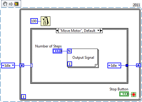

Hi SK0480,
Through the use of a State Machine architecture, you can execute a high level of control over the sequentiality of your software.
Through the use of a Shift Registers to pass around an Enumerated Control, you can control the execution through the use of a  Case Structure.
This design will allow the For Loop to operate only when the 'Move Motor' state is entered, otherwise the program will be idle.
Is this what you had in mind?

ok so as far as cases goes inside it...how can choose it externally instead of having the user press button...lets say through a local variabe
lets say If I add one more state then how can I choose more than two states because in the Vi you gave me it has a select Vi with two inputs only...IDLE or MOVE...but lets say If I want to have more than one variable what would be the procedure for that.

Let's NOT say a local variable. I would recommend you use a queue to feed actions into your state machine. (Technically once you have outside control of your state machine it is no longer a pure state machine but that is a whole other topic.) Use the queue within the While loop to determine the next action to take. You can post actions to the queue either within the loop or from outside in another task. Take a look at the producer/consumer examples to see how this is accomplished.
