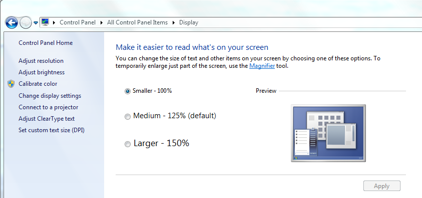

I have just received a new computer and installed LabView 2010 (same version as on my old computer).
On the new computer, it seams as all fonts, on the front panels and on the block diagrams, are too big. See attached images of the same VI opened on the two computers. My old computer runs Windows XP and the new computer Windows 7.
What could it be? It would be a lot of work for me to manually correct the fonts.

If you don't define a specific font for your panel, the "application font" used by LabVIEW is whatever is set for the windows theme.
Obviously, the two machines differ here.

Thanks altenbach, you pointed me to the solution.
If anyone else experience this issue, it is solved by changing the font size in Windows
(3,836 Views)
Not just font size comes into play here, but also the system font is different on an XP vs. a Vista or Win7 computer.
