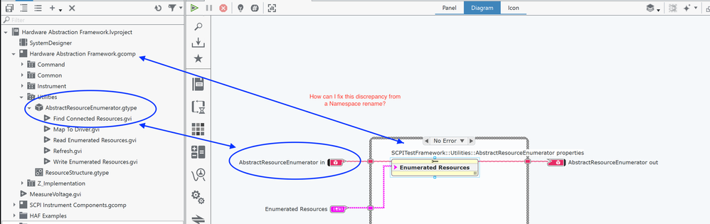

I renamed a namespace and I'm left with this discrepancy:
The code works, but the it's disconcerting to say these old names hanging around (SCPITestFramework was the original name.)  There's quite a few of these 'funnies' kicking around - it's not just namespaces, the rename feature doesn't seem to change all instances of the original name, although the application will still work.
Is there a way to fix these?

Hmmm, I've actually not seen this.  Or, more correctly, I haven't noticed it.  Have you tried hiding the label and then showing it again?  Maybe it's just a refresh issue.  I know this doesn't ultimately help you because you'd have to go through your entire code to fix them, but I'm curious.  What does the context help say?

The wire was actually added today but I renamed that namespace a week or more ago; all I'm doing in the above image is hovering the cursor on the wire.  So it affects new wires and old wires and seems fairly prevalent.  Same with other nodes as well: for example, I can drop a class instance onto the diagram and link a Class Properties and the name of that shows the old namespace as well.
My working theory is that internally, references are kept with some form of UUID so the app works, but in the saved files (XML??) the 'names' are not being changed and are read and presented as-is.  I've not wanted to fiddle with the files directly because NXG seems fairly fragile - it crashes and aborts a lot, rather than error out which is an issue with the way it saves, and I have to regularly clear the .cache file when it gets its knickers in a twist - so I don't want to do anything without specific guidance or advice.

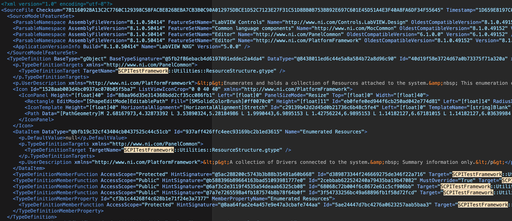

Fortunately, I don't need to worry about versioning conflicts (unless I get something very wrong!!)  The problem does lie in the XML files:
This is just a partial snapshot of the node I show.  It would appear that renaming a resource in NXG does not change the Target/TargetName attributes in the XML file(s); I assume that internally at least, it uses the various ID attributes which is why it still works.
I suppose the question is: "Can I do that manually?".  That checksum at the start would be a concern for a start.  But really, I'm refactoring quite a lot so how many times do I need to do it??  I have a lot of files so more times than I have the patience for, that's for sure.  But it's annoying in any case.

It’s worth closing this off.  I used BBEdit to find all occurrences of the old namespace in all project files and change to the new namespace (>3000 occurrences in my case although heaven only knows why so many!). Everything is good afterwards.
Really, this should be fixed.  What drove me to it was a working project on Friday evening, and a broken one on Saturday morning because at least one class and a couple of it’s VIs (not all of them though) had ‘changed’ to the new namespace and broken dependencies across multiple places.  How, I have no idea, nothing I did.

Hello Andrew and Bill,
I remember having this same problem when I did a project in NXG and having to ask our team "wait! Why is my name wrong if I already renamed the Library!" (I had a typo in my library's original name).
Turns out the Library has a namespace inside of it (similar to what VisualStudio does, of course, not fair to compare one to the other). This means that the library name and the namespace are different once the library is created.
To rename the namespace and have NXG do all that work of searching and replacing for you, just change the namespace name inside the library by right clicking on it in the following view:
