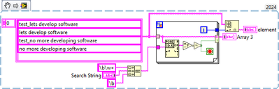

You mean like this:

Did you look at my second code example with the reg ex. You can type in Lets and it will find the one with test_ before it? I even made the search term a control so you could change that if you want to. I was using the word no and it would find the array value that had test_no in it.
