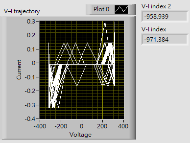

Figure 1:
Figure 2:
X input is the voltage value, Y input is the current value, if you want to find the area of the white in Figure 1, is there any way? Thank you

(1) I want to have a value to represent this graph for compare with other VI trajectory. Thus, I want to find all the area occupied by the white line.

(1) Your "line" is a 1D object in 2D space and does not have any area at all unless you define what you actually want (e.g. The area enclosed by the outermost lines.) Just blindly throwing an integration function at it makes absolutely no sense.

(1) I have tried to use Green' s Theorem to do this, but it is not work, because the value is still changing when the graph is stable.
How can find the biggest area of this XY graph (shown as below red line)?

  • Not sure what you are trying to show on your first image. Lots of it makes little sense.
  • If something does not work, attach a simplified version of your code AND some typical data. We cannot solve the problem based on sparse information. What precision do you need for the area. Seems your points are spaced quite far apart, joined by straight lines. I am sure there is a trivially simple solution! (I can think of some!). Is the data guaranteed to be convex with respect to X? (e.g. if you would turn your graph 90 degrees, things would be slightly more complicated).

For the first image in my last reply, it is refer to the Green's theorem. (https://forums.ni.com/t5/LabVIEW/How-to-calculate-area-of-a-XY-graph/td-p/2225898) I am using the code it this post and add it to my code's XY input (Voltage and current value). And I also tried Polygon Area VI.
The XY graph is VI trajectory plotted by the voltage and current waveform which are taken by USB-6008 real-time. The current waveform will change depended the power load.

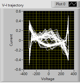

Power load 1)
Power load 2)
You can see that there is fluctuation in the "V-I index" when the graph have no significant change in above two examples. I think that I need to simplify the graph to outermost edge line only like the red line area photo in my last reply, then use Green's theorem or Polygon Area VI. But I have no idea for the simplification.

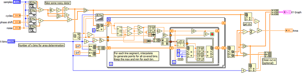

Accepted by topic author lst3201
See if this can give you some ideas. It would be easy to e.g. also smooth the area outline.
Calculation is purely numerical, but most likely sufficient for this.
(Probably needs a few tweaks. 😄 )
