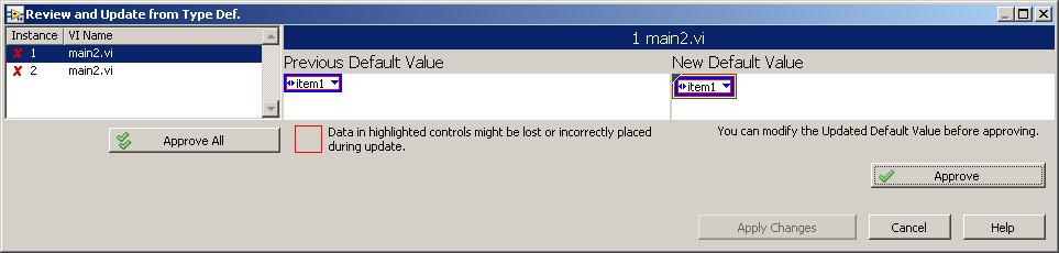

@Sam_Sharp wrote:
What you should have done here was update the original type definition - open the enum type definition, drop in a cluster, put your enum inside the cluster, add your other data types etc. then this change will propagate across everywhere the type definition is used.
That's exactly what I meant when I said
@antony Hatchkins wrote:
When I tried altering my [enum] typedef to a [cluster of enum+date] typedef
Next,
@Sam_Sharp wrote:
Note that your enum should also be a type definition (if it isn't already).
Yes, it is already. I thought I mentioned it, oh, yes, here it is:
[enum] typedef
Next,
@Sam_Sharp wrote:
> If I remember correctly, any time you update the type definition, any constants will reset to their default values when the update to the type definition propagates across your code.
No, Labview is smart enough to keep the selected value of constants intact in most cases of typedef editing. But wrapping an enum into a cluster inside that very same typedef is just a too complicated task for Labview 2011 to handle.
Update:
This issue has been addressed in Labview 2014, and what was impossible in 2011 is a piece of cake now!
It shows a nice dialog:
you approve everything it suggests a couple of times and that's it: all chosen values retain their values after putting enum into a cluster inside typedef!

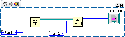

Some snippets to clarify the original problem (and summarize the answer):
That's what I had:
That's what I wanted:
What I tried was creating a new typedef (including manually replacing all instances of it) which
(apart from feeling that I'm doing it wrong 🙂 ) lead me to this:
After which I created a new queue indicator and needed to rename the variables pointing to it.
Now Mike's suggestion (in LV2011) of editing the existing typedef lead me to this:
that is, all enums were reset to the 0-th element - which is supposedly a bug.
The bug has been solved in LV2014, in which the procedure works flawlessly.
So I'm accepting Mike's answer in spite of his bad manners Smiley Wink
