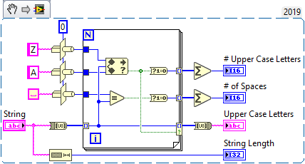

I'm unsure why @Abhilash_Adv felt compelled to add another reply to an eight-year-old post about finding capital letters in a string, but in my humble opinion, most of the proposed "solutions" missed some simplifications in asking "questions" about string elements (single characters).  If you convert the string to an Array of U8s, doing arithmetic (like comparisons) becomes much simpler and easier to understand.
Should you want to know the positions of, say, the Spaces or the Upper Case letters, bring the For Loop Index out through a Conditional (Array) tunnel with either the "Is Space" or the "Is Upper Case" condition wired to it.

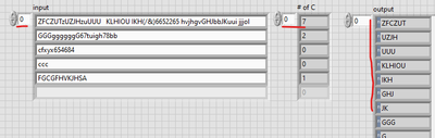

@ponorac92 wrote:
Hello, I have 10 strings and I need to search every sting for a capital letter. If there is a capital letter in a string I need to put the string in an array of strings. I don't know how to separate a string with a capital letter in it. If there is no capital letter than the string is skipped.  I tried using the Match Pattern function and it didn't help. Thanks in advance.
I used [A-Z]+
use [A-Z]+ with  "match regular expression" instead of "match pattern"and conditional auto-index the whole matches as an array of strings
offset past match will be -1 if there is no capital in the input entry and furthermore the while loop will execute 0 times if you check {offset past match}<0 and use that to stop the while loop..

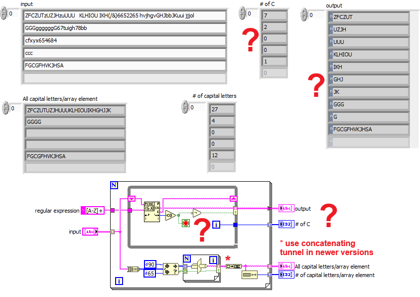

@alexderjuengere wrote:
I used [A-Z]+
You seem to create an array of string where each element is a consecutive stretch of capital letters. It is not obvious if that's what the OP wanted. Also, your "# of C" seems incorrect.
Also note that the use of REGEX will have a huge performance impact. Here's how my code would fit into your input:
(And yes, the OP wanted an array of capital letters, which would require some minor changes, of course, e.g. as follows)
you need to read that "[A-Z]+ is found 7 times in the index 0 input string".
