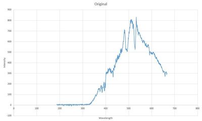

Hello I'm using Labview 2020 to collect data from an STS Ocean Insight Spectrometer and I could use some help applying some filters to the result spectra. The spectrometer outputs two arrays, one for the wavelengths detected and one for the intensity of those wavelengths, these I can then bundle and display on an XY Graph.
There are two things I would like to be able to do:
  • Set a minimum intensity threshold for detected wavelengths, if the intensity is below that threshold it will be set to 0, otherwise it will be displayed as is.
  • Have the option to only show a specific range of wavelengths. Eg. 300nm < X < 500nm would be displayed while all others would be set to 0.

This is all you need:
In general, it's better practice to simply not graph points you don't want to see, rather than set their y value to 0. So that's how I coded it, take the full set of data and filter out any data that is 1) outside the wavelength limits, and 2) beneath the minimum intensity threshold.
Replace those "don't want to see" points by NaN (instead of zero)!

Hi thanks for the reply, I understand your what you're saying about not plotting the points I want ignored and normally thats what I would do. But since this is a graph of a spectrum of light I would prefer to zero the unwanted signals as opposed to not plotting them, both from a practical sense as well as an aesthetic one. I won't lie, I find the zeroed out graph much nicer to look at than the one with most of the points missing.
OriginalOriginalPoints not PlottedPoints not PlottedReplaced with 0Replaced with 0
