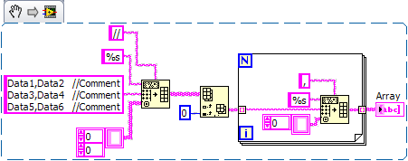

Part of my current work with LabVIEW, i need to parse a text file to get some data values for further processing. The file contains data in the following format.
Data1,Data2   //Comment.
For Processing, its required the Data1 and Data2. How shall i extract these information one by one from the file without comment.
Please comment on this.

Hi Favas,
like this:
17655iBCF41A43A59A9403
There are other ways too for sure...
And yes, please indicate threads with more or less the same topic...
In the original thread you asked for the comment, now you ask for the data. You can get the comment by expanding the IndexArray function to get the 2nd column.

Thank you for the comments.
I could able to solve the issue.
