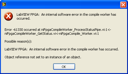

Here's the screenshot from the compile error. Appears just after the state goes to "Estimating Resources using PlanAhead".
The error also occurs when I start the Compile Server manually before starting the compilation.

I have seen dan_u 's same screen in compiling FPGA for a single board RIO, (LV 2012 SP1), with the slight difference that if you wait the error disappears and the standard compiling updates continue to a successful bitfile. Dan_u, have you given it a minute or two before hitting [CLOSE]? Just making sure whether it is the same issue.

dan_u,
When you click the "Details..." button, what information is there?
-Mello
I don't think it's still doing anything at that stage, and I'm quite sure I didn't always close the window when that happened (but of course restart the compilation). Anyway, even closing the window usually shouldn't do anything as it does not shut down the compiler.
I will check if it continues after a while just to be sure.
Message 6 of 27
(4,994 Views)
Details... gives me this:
By searching for the error code I actually found an old thread about a similar error (same error code but different error text and different behavior of subsequent compilations) in LV2011: http://forums.ni.com/t5/Real-Time-Measurement-and/LabVIEW-FPGA-compiling-error-61330/m-p/1829675
And I can confirm that waiting doesn't change anything. The compile worker doesn't seem to still be doing anything at that stage.

Hi Dan,
What you see looks like a Bug that was supposed to be fixed in LabVIEW 2012 (CAR #354983).
Is the issue only  happening with one project or with all of your projects? And do you know if it concerns only one workstation or if it can be reproduced elsewhere?
In the second case, could it be possible to get the project. I am curious to see if this still happens with LabVIEW 2013.
