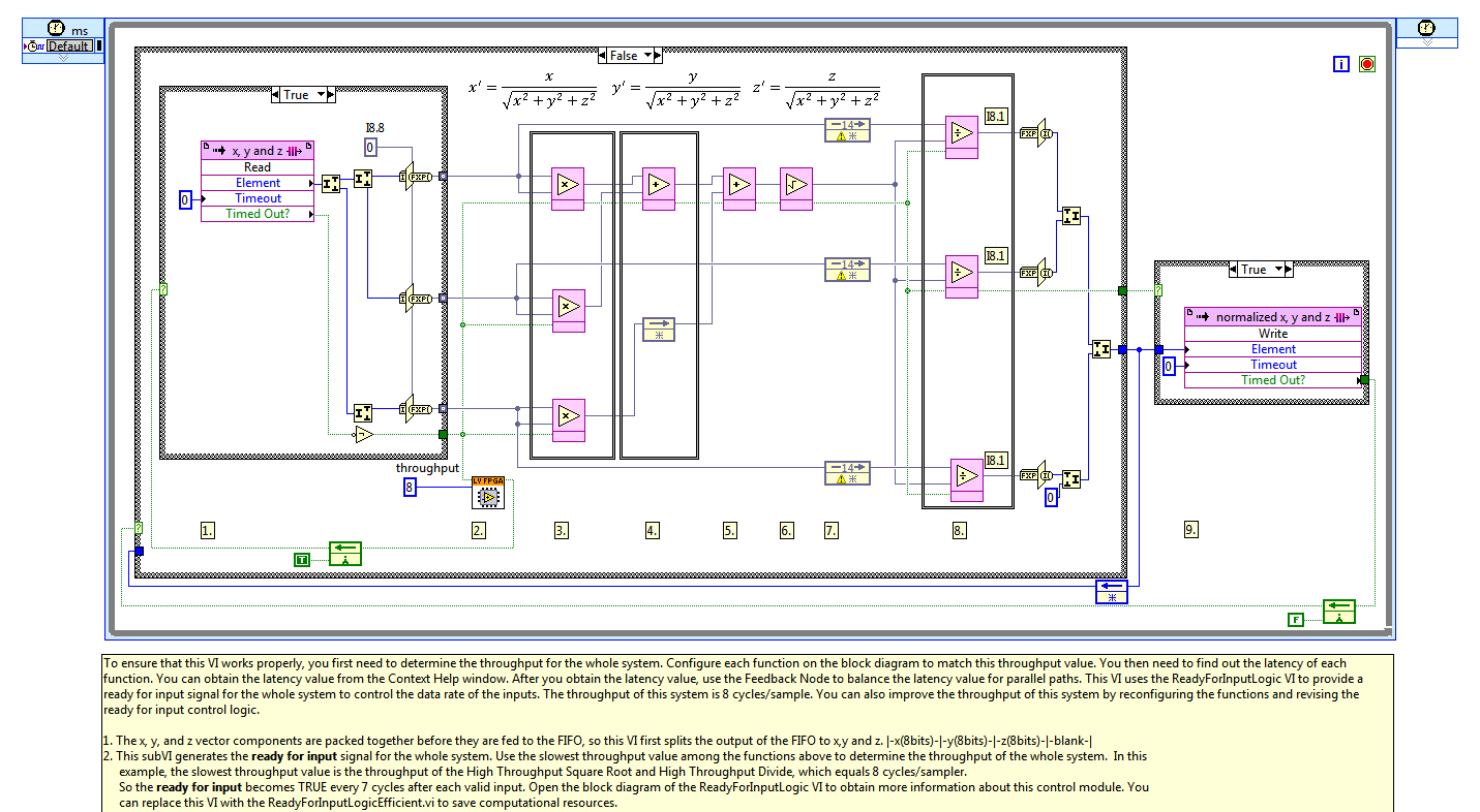

I've studied the Normalize vector LV FPGA examples and I have a question about the ready for input wire (see attachment for the diagram).
A subVI (named ReadyForInputLogic) is use to generate a ready for input signal  to TRUE every 7 cycles after each valid input.
I well understand the goal of this subVI but, is the subVI can be replaced by a wire between the "ready for input" output of the last divide block and the case diagram where the FIFO is read ?
I also studied the FFT Co-processing example and there is no need to use this kind oh subVI :
I've modified this example to add some multiply and divide blocks after the FFT block. So, the new whole throughput is increased to 8 cycles/sample (the FFT block is not the bottleneck).
Do I need to add the ReadyForInputLogic.vi subVI in my SCTL to read the FIFO every 8 cycles ?
Many thanks for any explanation
Yes you can but then you run the risk of dropping a result when the write to the FIFO fails because it is full. The logic is currently setup to stop processing vectors until the FIFO is not full.
You need to add up the latencies to determine how often you can read the FIFO. The FFT as setup in that example has a latency of >5600 cycles before the output is valid.

@BillMe wrote:
I would say yes, since the FIFO will be ready for a new sample before your math blocks.

Thank you for your answers. I think that I have to modify the VI's architecture.
I will try to remove some divide blocks in order to get to increase the FFT SCTL throughput. Like this, the FFT block will be the bottleneck.
The FFT post-processing blocks will be placed in an another SCTL. My FPGA VI will have 2 SCTL :
1 : FFT SCTL, which is processing the FFT + scaling factor
2 : Post FFT processing, in order to calculate the Magnitude and send it to the Host
I will post a new message when it will be ok !
Regards
(4,435 Views)
I'm sorry for my delayed answer but this is good working. Many thanks for your help !
