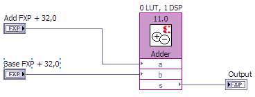

The above code usilised 33 LUTs.  The following code uses zero LUTs (1DSP).
2016-09-30 18_10_44-Conditional Adder.vi Block Diagram on Nanonis V5.lvproj_FPGA V5 _.png
