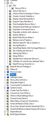

Please have a look on the project view of the locations of the classes and FGV, perhaps this is also wrong approach.
I understand perhaps starting with simple project to master this is the better way, but because this is kind of the addition to this project and I am on the clock in here under pressure, hoping to be put on the correct track by experienced users. Possibly I should not use the classes for this, although wanted to use OOP approach and changing this would have major impact on delivering this within already extended time. If you think it cannot be done in reasonable manner and have to change the way I tackle this then my bad and will have to add this extra time to get rid off the classes etc.
Please allow my lack of competence, still learning, but improvement is on it's way.
Thanks again for your time on this anyway, much appreciated.

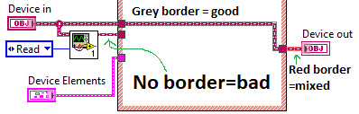

When the forum says "Attach", we generally mean "Attach the actual files as .VI, .lvclass, .ctl" files, not just taking screenshots of them.  It's also generally best to save them back to 2020 or so since a lot of forum members stay on old versions.
That said, what you're trying to do may well be possible, but the reason WHY you feel like you need to do things this way as well as why you feel that making them class-based is important is still unclear.  I would suggest backing up and posting all that information first so we can either fully understand what you're asking and legitimately help out, or say why exactly that you're doing something completely bonkers.
As for your initial error about "Run-time type not propagated from dynamic input to dynamic output":
Look at the above image.  The way OOP works in LabVIEW is that when you have a "Dynamic dispatch" VI (meaning one that is a class member that can be overridden by a descendant of the class), it must be LITERALLY IMPOSSIBLE for the class TYPE to change.  The data of the class can change, the instance of it can change, but the type absolutely cannot.  Because of this, LabVIEW looks for any code that could POSSIBLY cause a class change, and if it finds it, you get the error message you saw.
The two ways to avoid this problem are:
1. Always connect the same class wire that enters through a "Dynamic dispatch" input to a "Dynamic Dispatch" output.  Note that LabVIEW checks for this "sameness" through subVIs, no matter how nested they are.
2. If you think you need to replace the class wire somehow (rare, but possible) then you have to use the "Preserve run-time class" node to forcibly coerce any class to the class on the Dynamic Dispatch wire, which can and will discard class data if you use a class that doesn't work with it.
Now, what you're doing ("writing" a class to the wire) is not how Dynamic Dispatch works.  You can probably "fix" the error by changing the terminals on the VI connection pane to not be DD, but if we go back to my original point, I think there's a good chance you  don't fully understand how LabVIEW OOP works and are trying to do something bonkers, but you really really need to explain your motivation and architecture goals to us, not just show us error messages.
