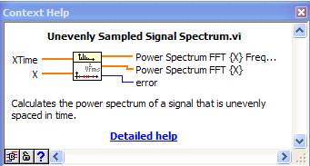

If you only want the power spectrum of your unevely sampled data, you could use the "Unevenly Sampled Signal Spectrum".
Alternatively, you could evenly resample your data by interpolation before feeding it to the FFT.
BTW: I cannot see your picture. Can you attach a VI with some typical data in a diagram constant?

Actually the FFT and power spectrum VIs in LabVIEW does not assume the x-axis of your input data.  You can use the VI on either time-based data or spaced based data.  The difference is how you interpret the x-axis of the output of the FFT results.
When you apply power spectrum calculation on a time-based waveform, you get the power of the signal vs frequency.  The unit of frequency is in Hz, which means cycles per seconds. When you apply power spectrum calculation on a space-based waveform, you get the power of the signal vs spatial frequency.  The unit of spactial frequency is in cycles per meter (Or cycles per "other unit you use for position measurement, for example, mm").
Back to the history, when Fourier invented the Fourier Transform, he did applied the transform on a spaced-based data, which is the temperature distrubution on a metal beam.
You data is sampled equally in space. So I compute the "deta position" with the first and second element in the position array and connect this deta to the dt input of the power spectrum VI.  Then the df output is the spatial frequency.  If the unit of your positin is in mm, the unit of the spactial frequency is cycles per mm.
Your data contains two scans (forward and backward).  You had better separate it to contain only the forward or backward data so that there is less leakage in the result power spectrum.
Please see the attached VI.
