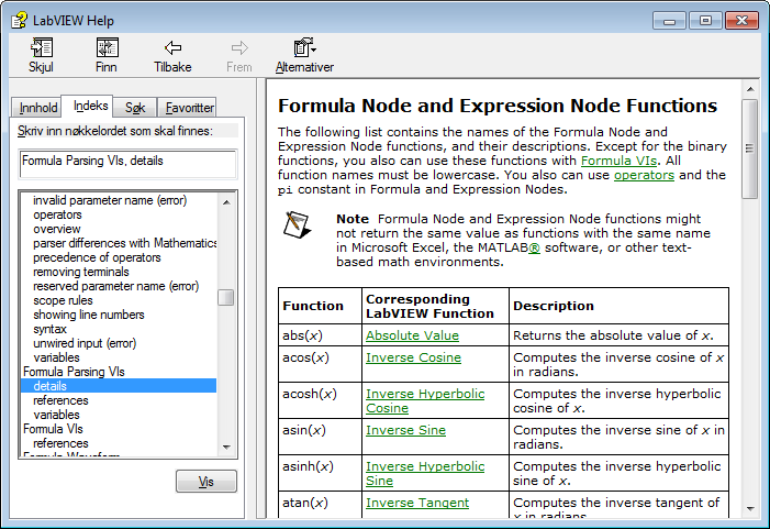

Found the old source code in the library.
Atleast of what I saw:
Abs(), cosh, sinh, tanh, log2, acos, atan, sqrt, ln, ^, acosh, asinh, csc, cot, atanh, log, sin, cos, asin, multiply, minus, divide, add
can be used. prob more

Youll find them all in the LV help: Smiley Happy
