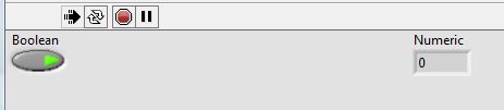

I need ideas on how to execute a delay only once after start (and that's it, no more calling the delay ever again after start) in a while loop without affecting other codes in that same loop...
Something like this http://forums.ni.com/t5/LabVIEW/put-a-delay-for-executing-case-structure/m-p/1095396/highlight/true#... but it is not workingSmiley Frustrated

I tried to use the code as attached in the link. But the indicator just shows 0. The delay VI in the link can be found in the very last picture...

How do you expect the subVI to delay only once if the main loop has a 5000ms delay?

Kindly run untitled 1.vi
delayed output.vi is for your reference.
Your "delayed output.vi" is faulty. You did not copy it correctly. The loop condition needs to be TRUE instead of FALSE. In your case, the subVI runs forever and never returns control to the calling VI.

I've switched the event of the TRUE and FALSE in the case structure in the delayed output.vi but it's still not working in my untitled 1.vi

Why? That makes no sense. You need to change the loop termination inside the subVI as I already mentioned.
