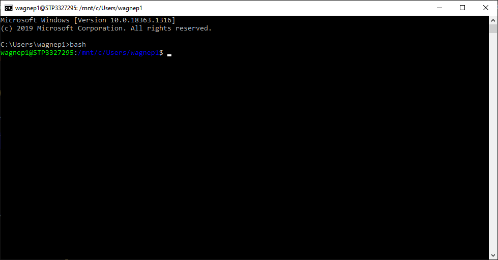

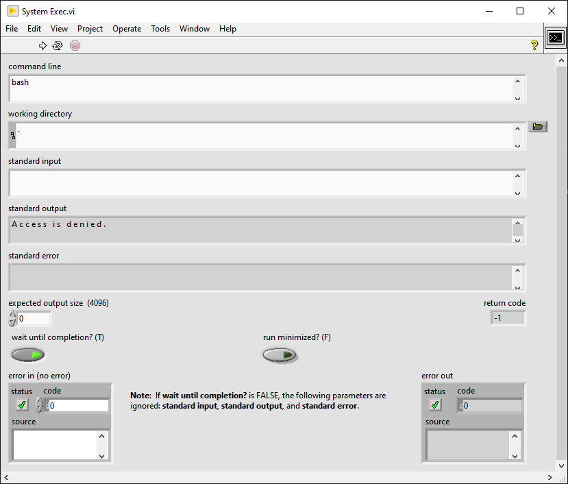

I want to execute a bash script (*.sh) from LabVIEW.  I have installed Ubuntu on WSL (https://ubuntu.com/wsl) and when I execute the "bash" command from the command line it works fine.  However, when I execute the "bash" command from LabVIEW command exe it gets the error "Access is denied".  Also, when I execute the "bash" command from a elevated command line I also get the "Access is denied".
Anybody know what going on here?  Does LabVIEW execute the command exe elevated?  If so, can I run it not elevated? Or, how can I run "bash" from an elevated cmd?

With ubuntu installed on Windows 10 following WSL install instruction (enable WSL in windows features of add/remove programs, reboot, install ubuntu from MS store) I can get the bash prompt by typing bash from the cmd line.  But when I execute "bash" from LabVIEW's system exe I get access denied.  Additionally, I get the same error when run from an elevated command prompt.

I haven't actually executed the script yet fully.  It requires some hardware and was returning errors.  But that is from the bash shell in ubuntu.  Reading online, I should be able to execute it from CMD using the "bash" command with the script as an input argument.  But, I can't even get that far because of the bash command itself causing the access denied error.
