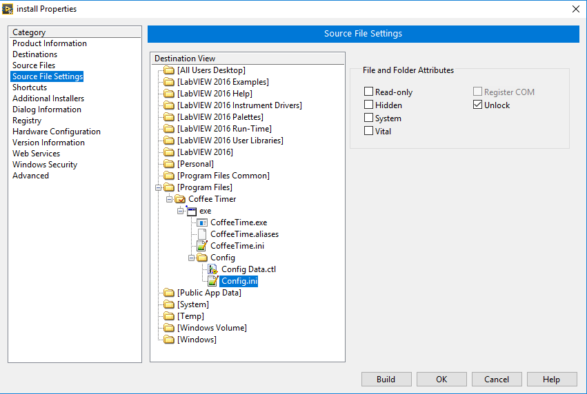

I would create an installer, then select the file you want the user to be able to write to (here it is config.ini) and check the "unlock" button.

@gregoryj:
     Thanks for the picture.  I've built a number of executables, but have not (yet) had to "drill down" to such detail to even realize that all those settings were available.
     My tendency has been to keep "rarely-changed" data, such as Configuration files, in "User-space", either in a defined Public Folder (which is where I tend to install the Executables, e.g. <Public>\LabVIEW Builds\<Project>\<Executable>\<Files go here>) or in a defined Data Folder accessable to the User.  So far, this has worked well and has required little variation in going from Windows XP -> Windows 7 -> Windows 8.x -> Windows 10.  But next week, Microsoft could change the rules yet again ...
Message 8 of 15
