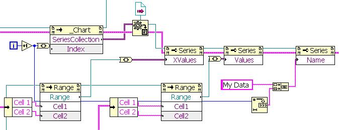

I use Active X to display XY graphs and its corresponding data on an excel sheet but i have difficulties playing with the series.
For example, the first graph corresponds to f(B)=A where A and B are excel columns, and the second corresponds to f(C)=A.
Unfortunately, on the second graph, the first serie f(B)=A appears even if I specify the correct range in SourceData. i tried to delete it with the Series Collection but i don't really know how to use this node with Labview.
Following is the VBA script :

I would be glad if i could get the graph corresponding to the specified range...and if someone can explain me how to use the SeriesCollection to be able to rename my series, delete some, etc...

I found how to rename series, but i am still searching how to define ranges like in excel : sheet1!R1C1:R100C2 to jump intermediate columns...
(5,118 Views)
Found the solution on this thread : http://forums.ni.com/ni/board/message?board.id=170&message.id=142170&query.id=1860717#M142170
I was giving bad arguments to XValues and Values...
